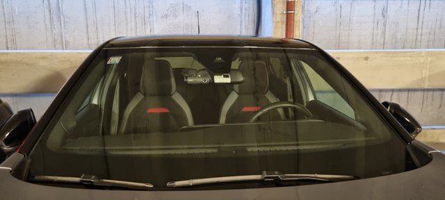

Where’s the best mounting spot? I’m thinking directly behind the rear‑view mirror in the blind spot, but that would partially cover the sensor at the mirror.
As for wiring, my plan is: ACC to F31 (cigarette lighter, live with ignition), constant 12V to F9 or F36 (interior lighting), and the third wire to ground.
